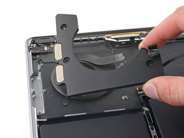

  31. MacBook Pro 13" 2022 (M2) Headphone Jack Replacement, Unfasten the left speaker: Schritt 31, Bild 1 von 1
    • Use your T5 Torx driver to remove the three 2.8 mm screws securing the left speaker.
    • The screws are held in place by rubber spacers. If you can't remove them, just make sure they are fully loosened.

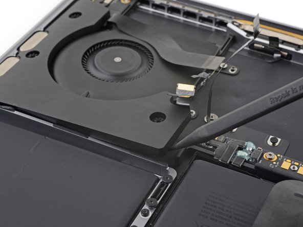

  32. MacBook Pro 13" 2022 (M2) Headphone Jack Replacement, Pry up the left speaker: Schritt 32, Bild 1 von 2 MacBook Pro 13" 2022 (M2) Headphone Jack Replacement, Pry up the left speaker: Schritt 32, Bild 2 von 2
    • Insert the point of your spudger between the right edge of the left speaker and the frame.
    • Pry the speaker out of its recess in the frame.
  33. MacBook Pro 13" 2022 (M2) Headphone Jack Replacement, Remove the left speaker: Schritt 33, Bild 1 von 2 MacBook Pro 13" 2022 (M2) Headphone Jack Replacement, Remove the left speaker: Schritt 33, Bild 2 von 2
    • Grab the right edge of the left speaker with your fingers.
    • Remove the speaker.

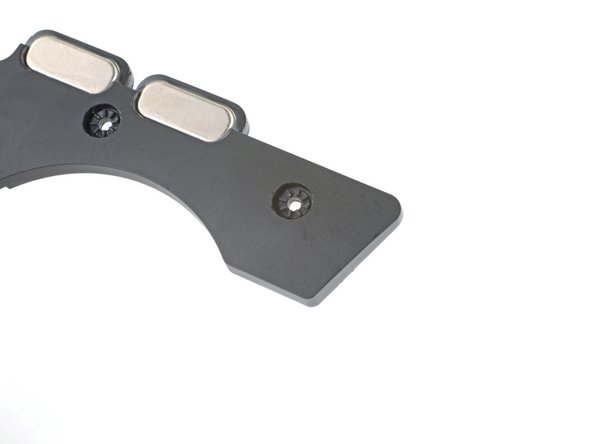

  34. MacBook Pro 13" 2022 (M2) Headphone Jack Replacement, Reassembly information: Schritt 34, Bild 1 von 3 MacBook Pro 13" 2022 (M2) Headphone Jack Replacement, Reassembly information: Schritt 34, Bild 2 von 3 MacBook Pro 13" 2022 (M2) Headphone Jack Replacement, Reassembly information: Schritt 34, Bild 3 von 3
    • The rubber spacers might stay on their screw posts in the frame when you remove the speakers.
    • Before reinstalling the speakers, follow these instructions to ensure the rubber spacers are in the speaker screw holes and not on the frame:
    • Orient each rubber spacer so the smooth side is poking out the underside of the speaker.
    • Insert one side of the spacer through the bottom of its screw hole.
    • Use the point of a spudger to press the spacer into its slot.

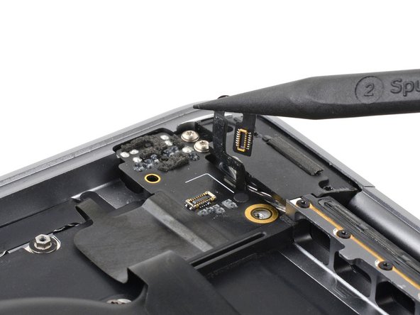

  35. MacBook Pro 13" 2022 (M2) Headphone Jack Replacement, Disconnect the headphone jack board: Schritt 35, Bild 1 von 3 MacBook Pro 13" 2022 (M2) Headphone Jack Replacement, Disconnect the headphone jack board: Schritt 35, Bild 2 von 3 MacBook Pro 13" 2022 (M2) Headphone Jack Replacement, Disconnect the headphone jack board: Schritt 35, Bild 3 von 3
    • Use the point of your spudger to pry up and disconnect the press connector from the headphone jack board.
    • Reposition the cable away from the board.

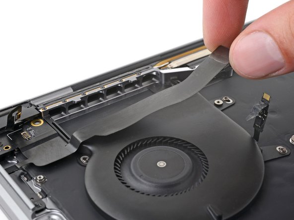

    • The interconnect cable is secured with light adhesive.
    • Separate the cable from the left fan.
  37. MacBook Pro 13" 2022 (M2) Headphone Jack Replacement, Soften the adhesive: Schritt 37, Bild 1 von 1
    • Apply highly-concentrated isopropyl alcohol (over 90%) to the section of cable under the headphone jack.
    • Wait one minute for the isopropyl alcohol to soften the adhesive.
  38. MacBook Pro 13" 2022 (M2) Headphone Jack Replacement, Peel the cable: Schritt 38, Bild 1 von 3 MacBook Pro 13" 2022 (M2) Headphone Jack Replacement, Peel the cable: Schritt 38, Bild 2 von 3 MacBook Pro 13" 2022 (M2) Headphone Jack Replacement, Peel the cable: Schritt 38, Bild 3 von 3
    In diesem Schritt verwendetes Werkzeug:
    • Use blunt nose tweezers to grab the upper section of cable adhered to the frame.
    • Slowly lift the cable straight up to loosen it from the frame.
    • Don't force or twist the cable. If it feels stuck, apply more isopropyl alcohol and try again.
    • Grab the bottom of the cable and peel it from the frame, making sure to avoid the circuitry on the cable.

  39. MacBook Pro 13" 2022 (M2) Headphone Jack Replacement, Remove the headphone jack: Schritt 39, Bild 1 von 3 MacBook Pro 13" 2022 (M2) Headphone Jack Replacement, Remove the headphone jack: Schritt 39, Bild 2 von 3 MacBook Pro 13" 2022 (M2) Headphone Jack Replacement, Remove the headphone jack: Schritt 39, Bild 3 von 3
    • Grab the right edge of the headphone jack board.
    • Angle the board up and slide it out of its recess to remove it.
Abschluss
