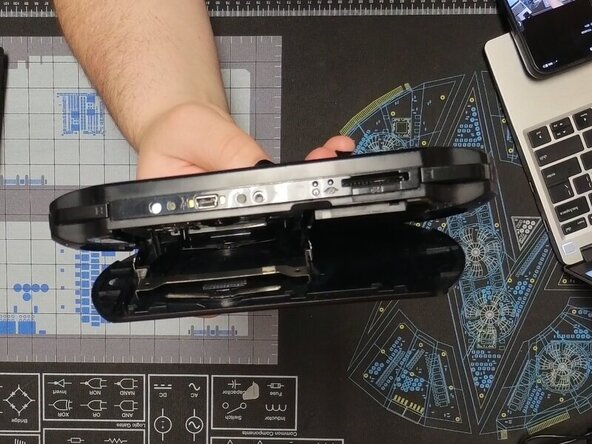

  2. PSP E1000 Battery Replacement: Schritt 2, Bild 1 von 2 PSP E1000 Battery Replacement: Schritt 2, Bild 2 von 2
    • We are going to start by removing the back panel.
    • To do this open the panel and gently squeeze in the UMD tray until it pops up.
    • It should lay flat against the back panel while open if done correctly

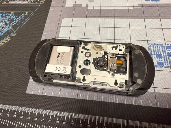

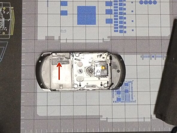

  4. PSP E1000 Battery Replacement: Schritt 5, Bild 1 von 3 PSP E1000 Battery Replacement: Schritt 5, Bild 2 von 3 PSP E1000 Battery Replacement: Schritt 5, Bild 3 von 3
    • Remove the screw with a #00 Philips and slide up the battery cover.
    • The battery can now be removed by pulling it out.
    • When reinstalling, it is useful to use a spudger to push the cable back in.
    • Congratulations you have replaced your PSP E1000's battery
