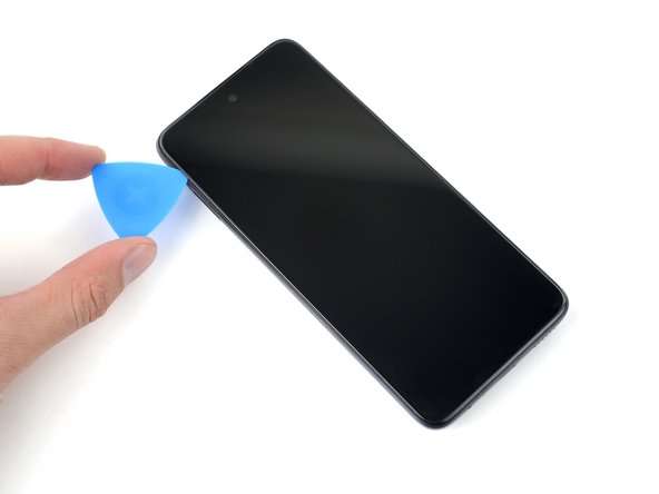

Apply a suction handle to the middle of the display's left edge, as close to the edge as possible.
Place the tip of an opening pick in the small gap between the back cover and the display.
Pull up on the suction cup with a strong, steady force and push the opening pick down at a 45 degree angle until it slides into the gap between the back cover and the display.
Slide the pick along the left edge down to the bottom left corner, and then up to the top left corner, to release the clips and slice the adhesive.
Leave the pick inserted in the top left corner to prevent the adhesive from resealing.
