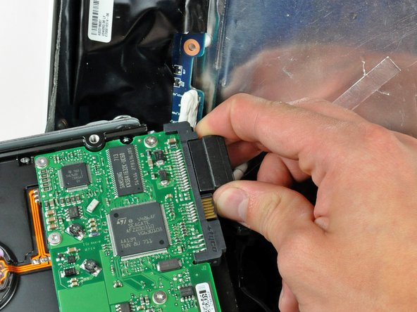

  • Pull both the SATA power and data cable connectors away from the hard drive.
  • Be careful when de-routing the hard drive thermal sensor cable from under the heat sink framework.
