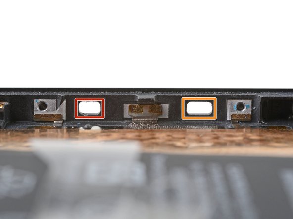

  28. Google Pixel Fold Volume Button Replacement, Disconnect the base battery: Schritt 28, Bild 1 von 2 Google Pixel Fold Volume Button Replacement, Disconnect the base battery: Schritt 28, Bild 2 von 2
    • There are two batteries you need to disconnect, one for each half of the phone.
    • Use the point of a spudger to pry up and disconnect the base battery cable press connector.
  29. Google Pixel Fold Volume Button Replacement, Remove the tape: Schritt 29, Bild 1 von 2 Google Pixel Fold Volume Button Replacement, Remove the tape: Schritt 29, Bild 2 von 2
    • Peel the grey conductive tape off the bottom interconnect cable.
  30. Google Pixel Fold Volume Button Replacement, Disconnect the flip battery: Schritt 30, Bild 1 von 3 Google Pixel Fold Volume Button Replacement, Disconnect the flip battery: Schritt 30, Bild 2 von 3 Google Pixel Fold Volume Button Replacement, Disconnect the flip battery: Schritt 30, Bild 3 von 3
    • Use a point of a spudger to pry up and disconnect the flip battery and bottom interconnect press connectors.
    • You have to disconnect both cables to keep the battery connector from accidentally touching the logic board.
  31. Google Pixel Fold Volume Button Replacement, Reassembly information: Schritt 31, Bild 1 von 3 Google Pixel Fold Volume Button Replacement, Reassembly information: Schritt 31, Bild 2 von 3 Google Pixel Fold Volume Button Replacement, Reassembly information: Schritt 31, Bild 3 von 3
    • During reassembly, the next two steps demonstrate how to replace the flip battery and bottom interconnect cable conductive tape.
    • Peel off the new conductive tape from its liner and apply the sticky side to the bottom interconnect connector, making sure to bridge the logic board.

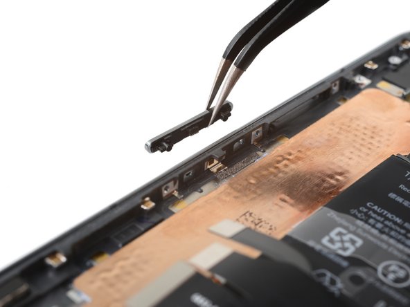

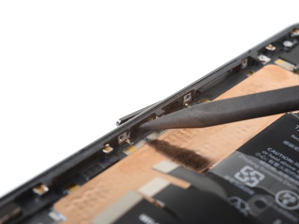

  35. Google Pixel Fold Volume Button Replacement, Remove the ultra wideband antenna: Schritt 35, Bild 1 von 2 Google Pixel Fold Volume Button Replacement, Remove the ultra wideband antenna: Schritt 35, Bild 2 von 2
    In diesem Schritt verwendetes Werkzeug:
    Tesa 61395 Tape
    $5.99
    • Peel up the ultra wideband antenna and remove it.

  65. Google Pixel Fold Volume Button Replacement, Remove the volume button: Schritt 65, Bild 1 von 3 Google Pixel Fold Volume Button Replacement, Remove the volume button: Schritt 65, Bild 2 von 3 Google Pixel Fold Volume Button Replacement, Remove the volume button: Schritt 65, Bild 3 von 3
    • Use the point of a spudger to push the volume button pegs out of their recesses in the frame.
    • You may need to alternate pegs a few times to completely separate them.
    • Remove the volume button.
  66. Google Pixel Fold Volume Button Replacement, Reassembly information: Schritt 66, Bild 1 von 2 Google Pixel Fold Volume Button Replacement, Reassembly information: Schritt 66, Bild 2 von 2
    • During reassembly, make sure the volume button pegs go in their matching slots before pressing them through the frame.
